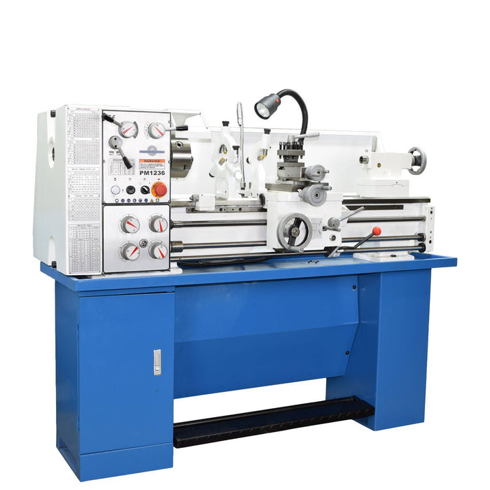

  • D1-4 Camlock Spindle Mount, for easy chuck changes
  • HEAVY CAST IRON Base option now available, for greater rigidity and vibration dampening
  • 1-1/2" Spindle Bore
  • Feed Rod has a clutch with Preferred Package, for safety, and to allow the use of a Micrometer Carriage Stop
  • 220V Single Phase Power, no phase converters needed
  • Short spindle length, great for gunsmithing operations through the headstock
  • Priced very, very reasonably when compared with other similar models – Compare Carefully
  • Leadscrews Are True Inch Pitch Screws (Not Metric Conversions Like Many), 10 Threads Per Inch (.100” Per Turn), and 8 TPI for Main Leadscrew for easy threading operations
  • Backed by an industry leading 3 year warranty
  • More Details
PM-1236 Main Features
  • D1-4 Camlock Spindle Mount for quick chuck changes
  • Feed Rod Clutch is now standard, to allow Micro Carriage Stop use with feed, and extra safety safety margin in case of overloading
  • Many Accessories Included as Standard, see list to compare with other lathes in this size range
  • LED Work Light Available
  • Base Is Included - NEW Cast Iron Base Upgrade available, gain extra rigidity and vibration dampening with this option
  • Inch and Metric Reading Dials are standard
  • Wide Speed Range, 18 Steps from 65-1810 RPM
  • Induction Hardened and Ground Ways and Gears, for Extremely Long Service Life
  • High Precision, Adjustable Tapered Roller Bearings Used on the Spindle, Ball Bearings Used on All Other Shafts in the Headstock
  • Best Available Threading/Feedbox Design, In an oil bath, for Easier, More Reliable Feed/Thread Changes, and Much Longer Life
  • Geared Head for Easy and Quick Speed Changes
