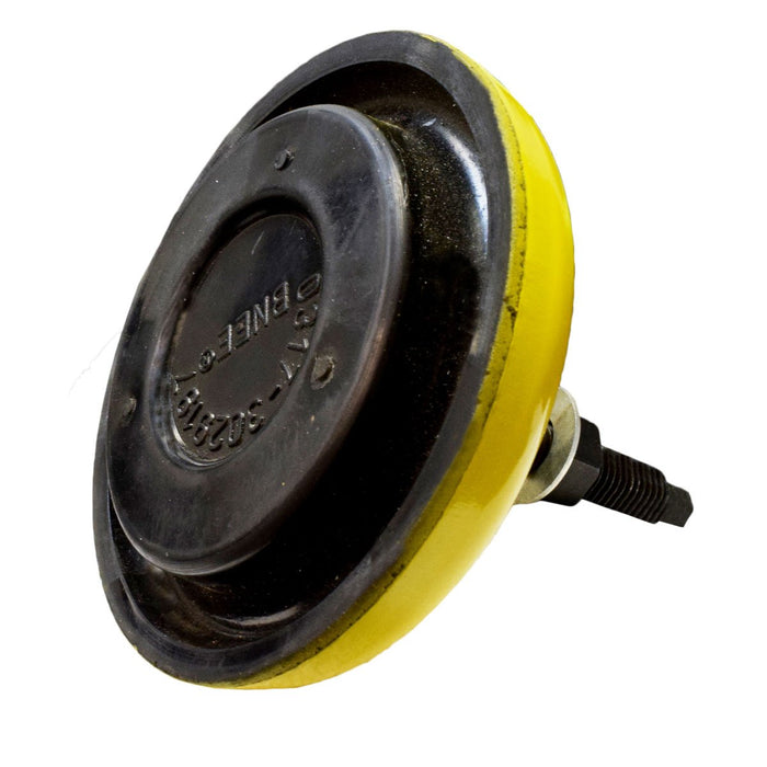

  • Elastomers is make of Nitrile rubber compound, it can resist most oils and coolants

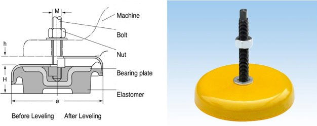

  • Simply set machine on leveling pads, and use threaded stud for adjustment. To raise pad, tighten threaded stud, to lower pad, loosen threaded stud. Once adjusted, tighten jam nut to secure it in place.

  • Dimensions from picture below H = 1-1/4", h = 1/2", Diameter is 4.7"
